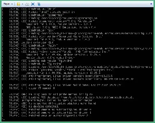

I have tried several tutorials to install the drivers manually but without success. The 7900 is listed as a supported card at the AMD drivers page and I have tried both the stable and the beta release however without much success. After the last listed tutorial the system boots to the login screen where it returns after entering the password (with a short black screen inbetween). VMWare Here is my Xorg log (/var/log/Xorg.1.log) at the place where the error occurs: /var/log/Xorg.1.log:

VMware based virtual machine products emulate a graphics controller, you cannot use HD7900 graphics driver within the vm because the vm has a different graphics controller, you must install drivers for your card on the host os, and install vmware tools in the guest os. If you would like to attach a real graphics controller to a virtual machine you will need to use an alternative software that supports pci-e vm inputs such as Parrallels Workstation Extreme, in which case you need two graphics cards (1 for the host, 1 for the guest).
For more information about connecting pci-e devices to a vm directly read this: http://kb.parallels.com/en/9427
