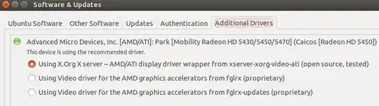

I just upgraded to 14.10 from 14.04, and the built-in driver for my ATI Radeon HD 5450 sorta-kinda works okay because I do get a signal on my monitor, but it lacks any kind of acceleration, making the Dash and the menu reallly slow, and even typing this post has a significant keyboard-to-screen lag. What's more, the built-in drivers don't seem to support screen standby, so the monitor stays on forever :-/
I've tried several*) methods of getting proprietary drivers to work, but they all fail the same way: the boot simply ends at tty1 instead of going into the graphical mode.

You can Install Xserver Xorg driver in command line. You dont need to install from the Software & Update.
Just run this in command line
sudo apt-get install xserver-xorg-video-ati
See here at packages.ubuntu.com. Version is 1.17
Well things have changed since the release of Omega driver which have support up to version 1.16 of X. Head to AMD website to download the driver.
