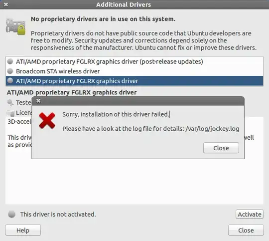

The open source driver worked well with the fresh installation of Ubuntu 12.04, but it drains my laptop battery faster. So I installed the proprietary driver from jockey-gtk. It gave me this error message at the end of the installation:

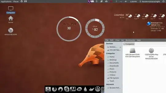

After restarting the computer, I lost all the compositing animations. Compiz visual effects don't work. There is a black boarder around Docky.

Here is the jockey.log & the fglrx installation log
