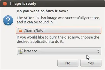

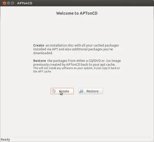

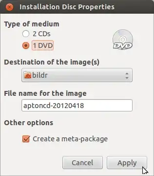

You need to get a PC with Internet connection first, where you can download required .deb files. Once you have downloaded all the files, You can now create a CD/DVD rom or ISO file which can you use to install the software you have downloaded in your offline PC.
Start with a clean install or VM.
sudo apt-get install aptoncd
Install the packages you want on one PC
sudo apt-get install gbrainy
Run aptoncd
Click Create
Click Burn and set options then Apply
Burn it or save it
Note that aptoncd only backs up things in the current apt-cache.
This is why we started with a clean VM/new install and did all of this in one run.

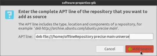

Offline Repository
How to create an offline repository is described here: you just have to download the appropriate files from archive.ubuntu.com; alternatively, you could use apt-medium.
EDIT: Another approach based on a local archive of *.deb files is described in different blog entries (see here and here). Sarath Chandra summarizes as follows:
Make a dir accessible (at least by root)
sudo mkdir /var/my-local-repoCopy all the deb files to this directory.
Make the directory as a gzip:
sudo bash -c 'dpkg-scanpackages /var/my-local-repo /dev/null | gzip -c9 > /var/my-local-repo/Packages.gz'or
sudo dpkg-scanpackages /var/my-local-repo /dev/null | gzip -c9 > /var/my-local-repo/Packages.gzAdd the local repo to sources
echo "deb file:/var/my-local-repo ./" > /tmp/my-local.list sudo mv /tmp/my-local.list /etc/apt/sources.list.d/my-local.list sudo apt-get update

Next, after having the updated repositories downloaded, you'd place the downloaded files arranged in a proper structure (as shown above) in a directory of the target offline computer. Save the directory structure
precisein a folder named offlineRepository/dists/precise in your user home (~/offlineRepository/dists/precise) or anywhere else (/home/offlineRepository/dists/preciseusing sudo previleges in a terminal or with Nautilus file manager started withgksu nautilus; also make sure you have the right permissions for the copied structure). Your offline repository information would then be ready for use.Add the local repository in your sources list. With Ubuntu Software Centre, go to Edit -> Software Sources ... -> Other Software -> Add... and then in the field for APT line, add:
deb file:///home/offlineRepository precise main universeand click Add Source. Be sure you modify the line as to your directory/file structure and suite. Then reload the packages or runsudo apt-get updatein a terminal.
