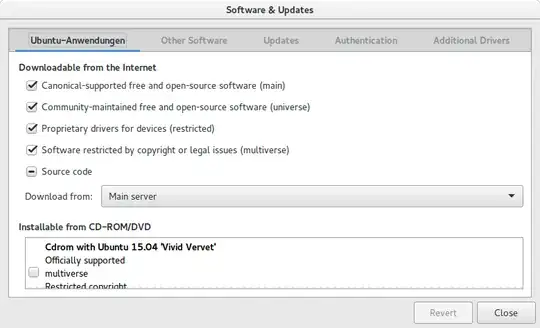

First check this in Ubuntu:
Open the Ubuntu Software Center
Go to Edit > Software Sources
Check the 2nd entry Community-maintained free and open-source software (universe
Close

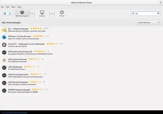

Then use the Ubuntu Software Center or use a terminal
Search for VLC and install the package
The terminal way
Open a terminal in Ubuntu with Ctrl+Alt+T and execute the following commands:
sudo apt-get update
sudo apt-get install vlc
in order to install VLC 2.1.6.
