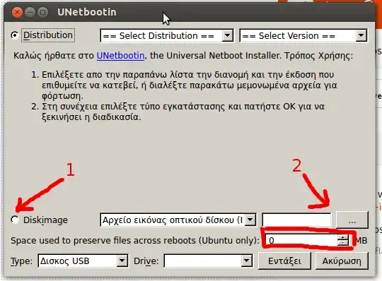

It is doable. You will need UNetBootin for this. It utilizes overlay-FS to make changes persist. Running the program will give you something similar to this screenshotscreenshot
Select the radio button labeled "Diskimage" (1), then the button labeled "..." (2) to select the .iso image from your local filesystem. Now type in the size of the overlay-FS that will be available to your system in the textbox (red square).
We are almost there. All that's left to do is select the USB device from the drop-down labeled "Drive" and hit the button labeled "Εντάξει" in my screenshot.
