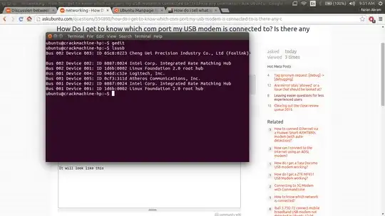

Execute following command in terminal :
lsusb
It will look like this enter image description here
You see the device 004 : .... shows logitech Inc, it is the port where my usb mouse is attached, check your usb devices and see the name of your modem corresponding to device 00X.
