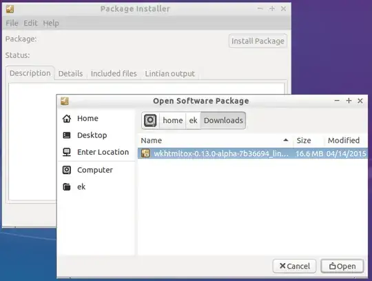

The graphical frontends may also be called without arguments (e.g., gksudo gdebi-gtk), in which case you may click File > Open to browse for and select the .deb file from within the GUI.
Screenshot of the Open Software Package dialog in gdebi-gtk
