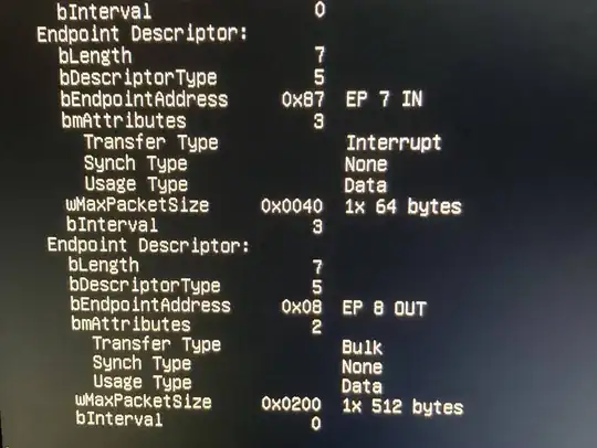

lsusb -v output for wifi adapter (photos of a screen showing a terminal):
photo of a screen showing a terminal
another photo of a screen showing a terminal
