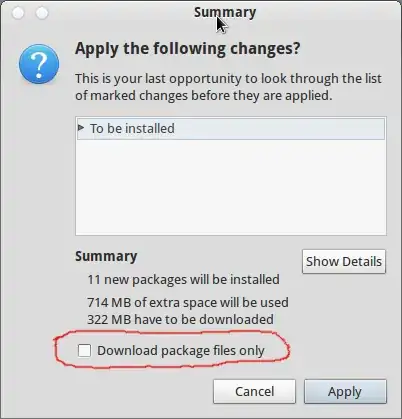

  • Open Synaptic and first hit "Reload", when its done, click "Mark All Upgrades" and then hit "Apply", this will bring a dialog that shows packages to be updated, below that is a checkbox that says "Download Package Files Only".
Package Installation Confirmation Dialog
  • Just mark that checkbox so it'll not install anything and just download the packages and keep it in the cache.
  • When its done, install other packages that you'll need, like ubuntu-restricted-extras, vlc, gnome-shell, etc.
  • Mark the mentioned packages (it'll also mark required dependencies) just DON'T forget to check that "Download Package Files Only" option, when you click apply after marking all the packages.
