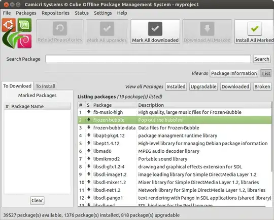

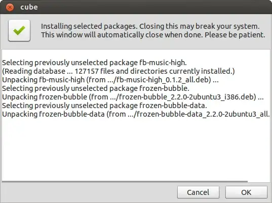

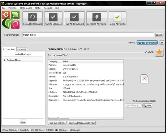

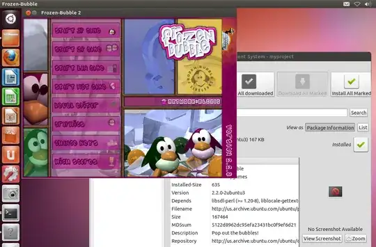

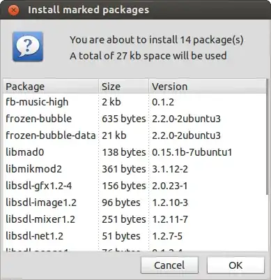

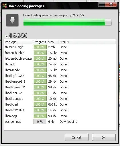

You can use Cube. It is a offline package management system (offline apt-get equivalent) that downloads .deb and its dependency packages in any computer with internet connection (You can run it also in your USB Stick) and install it offline in later use. It is portable so no additional installation needed.
Searching and Downloading Applications "Frozen Bubble" (Microsoft Windows XP)
Searching Frozen Bubble
Downloading it and it's dependencies
Downloading Packages
Installing Application (Ubuntu 12.04)
Finding Frozen Bubble
Verifying dependencies
Dependencies
Installing it in the system
Installing
Using it
You can download it here : Cube Launchpad Page . A zip and tutorial is included in the download page. You can check the tutorial for instructions.
