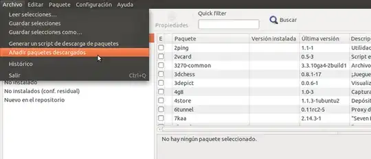

For save only your updates:
Save all the package, files located in /var/cache/apt/archives. And do a backup of the repository indexes, files located in /var/lib/apt/lists.
Now in the other computer launch Synaptic and select: File->Add Package Downloaded
screenshoot
Then search the folder were you put the files and open it, accept all. With your repository indexes you will not have dependency problems.
