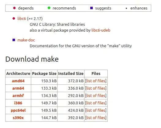

The second alternative, often the one week option, is to go here: https://packages.ubuntu.com/ Select artful, the code name for Ubuntu 17.10. Find the missing packages, in your case, linux-libc-dev, make, build-essential and dpkg-dev. Be certain to also download the dependencies of the dependencies. For instance, as you see by the red dot, make depends on libc6.
