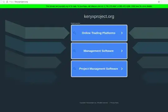

Keryx the accepted answer is not the answer am after. Nor is APToncd. How can I install software or packages without Internet (offline)? Keryx
