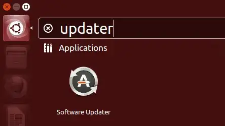

Launch the Dash and search for Update Manager to see if there are updates to install:
If you do not launch the Update Manager, it will prompt itself each time there are new updates to ask you whether you want to update your packages or not.
