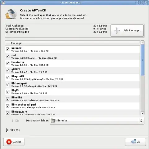

Use APT on CD
The gui interface for backing up deb files!
