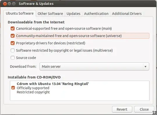

    1. Adding the "Universe" repository to your software sources (from Ubuntu system settings > Software & updates)
      Software & Updates

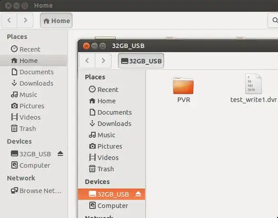

Copy data from the live system to an external drive
To be able to save our data to an external drive we need to mount both the recovered partitions and the external USB drive in the live environment. The below picture shows how the USB drive will be mounted on insertion (the internal partitions will be mounted on selecting them):
We can then copy & paste (or drag & drop) our rescued files from the internal drive to the external drive (e.g. by opening a separate Nautilus window, or in releases < 13.04 by adding an extra pane with F3 ). From the terminal we can issue:
cp -a /<mountpoint_source>/* /media/ubuntu/<name_destination>
After sucessful copy we need to unmount the drives to avoid data loss. This will be done in Nautilus from a right click context menu or in the terminal:
sudo umount /media/ubuntu/<name>

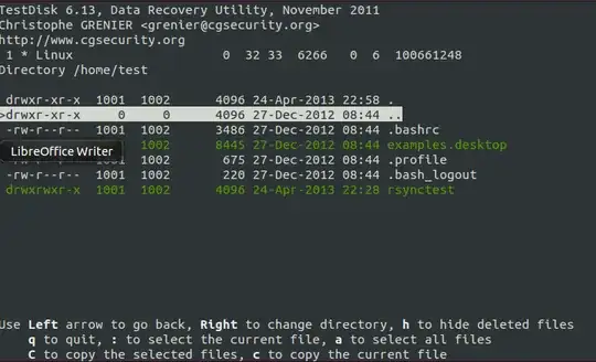

Copy single files using testdisk
In case we were unable or did not want to recover the partition table we may try to copy selected files or directories with testdisk from the <Advanced> Filesystem Utils menu:

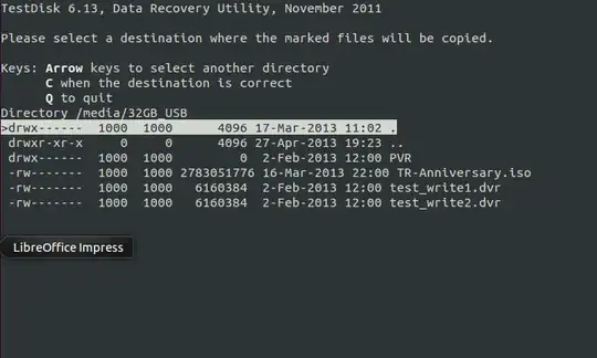

In above example I had selected examples.desktop and rsynctest folder by pressing : . To copy these files we press C for the next menu giving the file hierarchy of our running system. We have to browse to the mountpoint of our external drive (here /media/23GB_USB but this will probably be /media/ubuntu/<name_of_device in your case). The content of our USB is now listed, and can be browsed for deeper directories:
When we press C in the example above our above selected example.desktop, and the folder rsynctest will be copied to the external USB drive.
To verify we had succeeded we can now open Nautilus in our live system and see the content of the rescued files. After we are done, do not forget to unmount the USB drive.

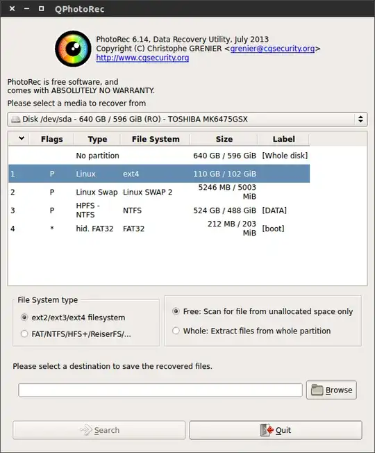

Since no one provided a GUI alternatives for the terminal impaired Ubuntu users, here is a GUI for Testdisk.
  • Insert your Ubuntu CD/DVD/USB and boot from it
    • At boot-up, select try Ubuntu out.
  • Download qphotorec.
    • Install like so: sudo dpkg -i qphotorec_1.0_all.deb
    • If there are any dependencies issues, run: sudo apt-get -f install
  • After qphotorec installation, execute it, like so: qphotorec or search via the dash, for qphotorec
    • Select the drive you want to recover, and where you want to recover all the data too.
  • Pray to our Human Deity, and hope you get everything back.
