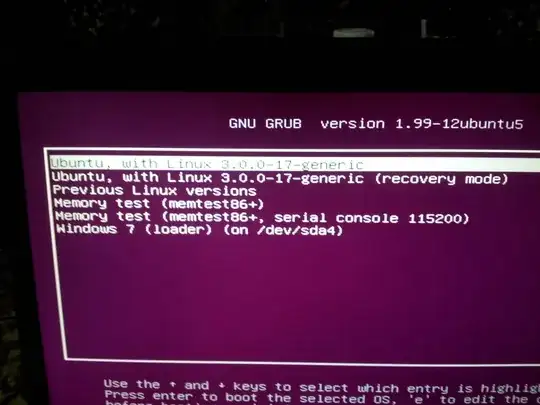

No, your Windows partition is still there. There is a glitch in Ubuntu that happens sometimes and it occurs after Ubuntu install, for some reason it does not send you to the grub menu to decide if you want to boot Ubuntu or Windows.
Here's the fix for this problem:
Shut down your computer. (If it's already on, if it is off, just go ahead and turn on your computer).
Turn on your computer.
Next, hold the shift key at boot.
Then, you will see the grub menu. Windows should be one of the options on the grub menu. Select Windows, and then you are good to go. Screenshot:enter image description here
