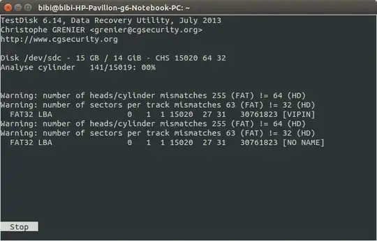

Boot from a live CD or USB.
Install TestDisk and Mount the drive then open a terminal and run
 sudo testdisk
follow these steps
here you have to select your hard disk. enter image description here

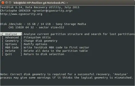

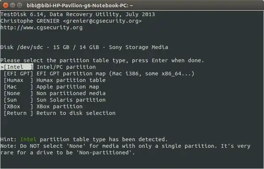

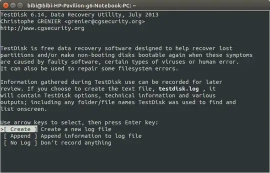

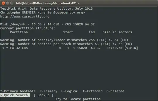

enter image description here enter image description here enter image description here enter image description here enter image description here enter image description here

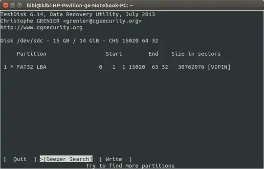

Deeper Search (this should find your old partition, you can stop it after it found it)
enter image description here Once you found what you think it's your partition select it with up/down arrows
[P] for list files and look if it seems it
[q] to quit list files

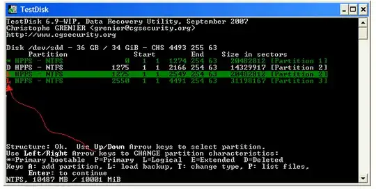

I have changed pictures for better understanding. This is from wiki link at bottom

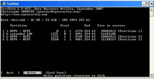

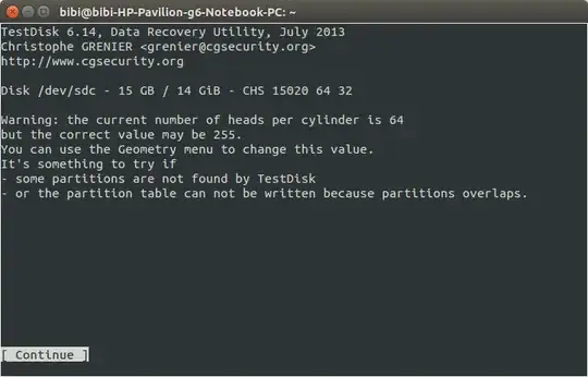

enter image description here Using the left/right arrow keys, change the status of the selected partition from D(eleted) to L(ogical). This way you will be able to recover this partition
[enter] continue
When all partitions are available and data correctly listed, you can select Write to save the partition structure.
more detailed step by step instructions for TestDisk data recovery can be found here http://www.cgsecurity.org/wiki/TestDisk_Step_By_Step and here http://www.dedoimedo.com/computers/linux-data-recovery.html
