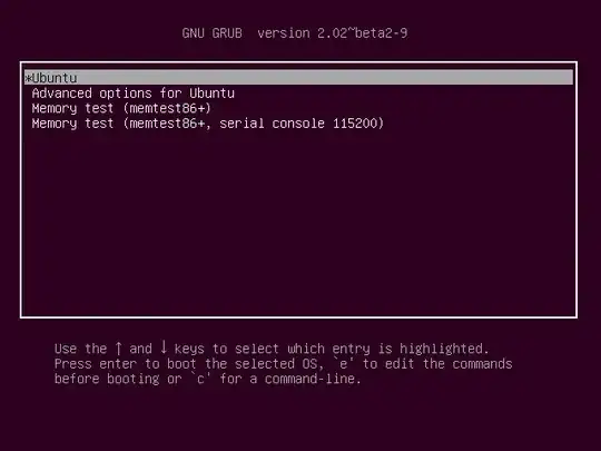

The installation of Ubuntu went flawlessly. After reboot it started with that screen with Ubuntu logo on it, but no GRUB screen as expected, where there should have been the option to choose between Windows and Ubuntu. I tried to find a solution for my problem and found that I need a Boot Repair. I used boot repair several attempts but it partially solved my problem. I now start with a GRUB welcome screen, but there is still no option to choose Windows.

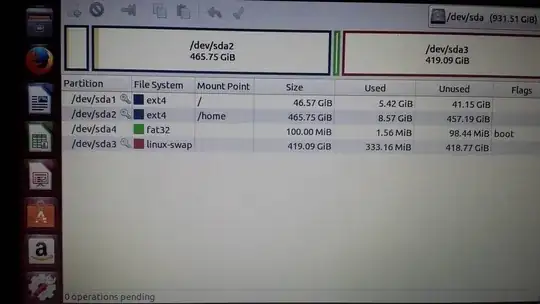

Analyzing what I've done wrong I found that I made a huge mistake with partitioning. I have a 1TB HDD, which I have partitioned as shown in the below screenshot. I believe I am the only idiot on this planet who has ever done this.
partitions
I could use the recovery drive to backup Windows, but I've got these questions, which may look stupid, but I would appreciate some good answers:
  1. How bad can affect my data from HDD my "genius" way of partitioning? Is it reversible?
  2. Considering the way I have done the partitioning, if I decide to use the recovery drive to repair Windows, what are my chances to have a good result, without losing all my data? I think it's a pipe dream.

Unfortunately it looks like the problem was that during the install you formatted Windows off the drive. In your Gparted image here notice there is no partition marked as Microsoft or Windows. Not seeing the grub menu on boot is the standard behaviour for a system that only has Ubuntu installed on it. It looks like you will need to restore your Windows and install Ubuntu again. During the install process for Ubuntu you are given an option to install alongside your existing operating system.
