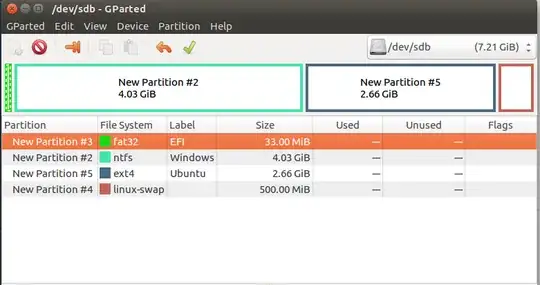

And just for the sake of completeness and education, here's a representation of what happened:
  1. Initial state, Windows installed.
    Your system before doing anything at all. Initial state
  2. Post-Ubuntu Install.
    At this point, Windows + Ubuntu worked fine with a bit of tweaking. Win+Ubuntu Coexisting
  3. After dd (real) This is the point where everything goes south. The image you wrote to /dev/sda has overwritten your partition data, the EFI boot partition (possibly?), and most importantly, your partition table. Note how your Windows partition has "shrank" from the left. Any data in that shrunk portion is unrecoverable. You'd be able to recover anything in the old NTFS footprint (the selected partition). Aftermath 1
  4. After dd (according to partition table)
    This is how your hard drive looks like to your partition table. It is not an accurate representation of your hard drive anymore. Aftermath 2
Of course, this is not an accurate model because I just made it with gparted using a sacrificial flash drive to try to explain the point. As such, it's really the concept here that matters. Your system may have been different (especially with partition sizes).
