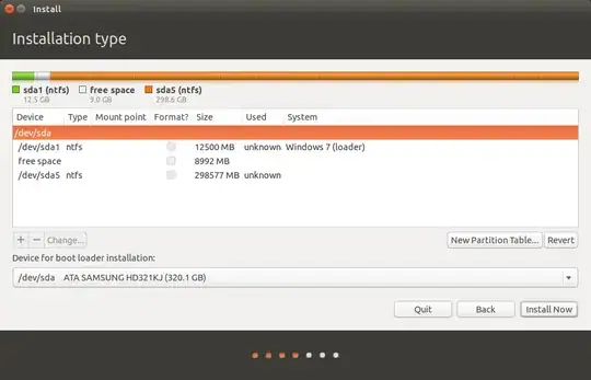

It was a ~22 GBytes first windows partition (with loader). I wanted to split it on 2: 13 GB and 9 GB. In the middle of process was an error with something similar to "unable to write data on media (on disk?)".
After this I got 2 partitions:
Windows ntfs partition with remark: (used space unknown).
Unused space
This is what it looks like now: Partition table at installation
At this point I've stopped everything and came here.
(It seems that windows cannot start. But I didn't try too much. I can't be sure that all my files were successfully transferred to the resized partition.)
