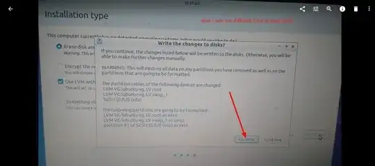

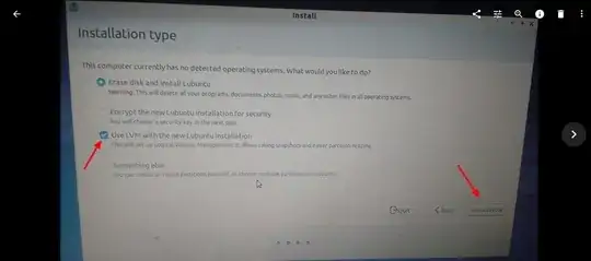

My partitions disappeared after Lubuntu Live CD now there sda5 which will not mount. It was Lubuntu 14.
I looked around to see if an install is too difficult. I liked Linux puppy because was not so dangerous or difficult.
But I went back after seeing it's not for normal people.

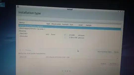

But it didn't go back. It stayed changed from my (sda1 sda2 sda3) to sda5. I never choose or made sda5 (see picture). When I saw it looks dangerous I went back but sda5 stayed and my old partitions sda1 to sda3 didn't show up again.
In sda3 which is Packard Bell laptops windows original partit had my pics and my puppy Linux sfs collections. There was no writing action so nothing can be really deleted.
How to get all back? if I put puppy Linux CD in and start with puppy it is nothing there even parit5 is not to mount is the message.
Does sudo testdisk not work because I'm on a live CD?
I probably need a boot tool like puppy. What should I download? I have a second laptop so I can burn DVD. What should I do to get stuff back? The pics belong to somebody else and laptop actually too.

YEAHHHHHHHHHHHHH SEEEMMM TO BE BACK
THINK FOUND IN PUPPY FORUM :
https://www.dedoimedo.com/computers/linux-data-recovery.html
PUPPY RESCUE 2.5 SELBOOTABLE dvdISO WITH TEST.. AND PROBABLY OTHER TOOLS
ALL PARTIT BACK:)))) hurrraaaaaaaaaaaaaaaa
TEST... DIDINT WORKED IN LIVE LUBUNTU :(( I REMEBER SHOWED JUST MY CD ROMM NOTHING MORE!!!
but here in resckue puppy 2.5 test.. showed all deleted partit and recovered them:)))
https://www.awesomescreenshot.com/image/3286530/79c890eb5f1cd57c5c78d20c4e7f3115
https://www.awesomescreenshot.com/image/3286534/59d746f3344310f35128d52ec35ade12
http://smokey01.com/CatDude/ISOs/PupRescue/2.5/PupRescue_2.5.iso https://www.awesomescreenshot.com/image/3286549/1570ed19b1a88f61a2720a00540537c9
