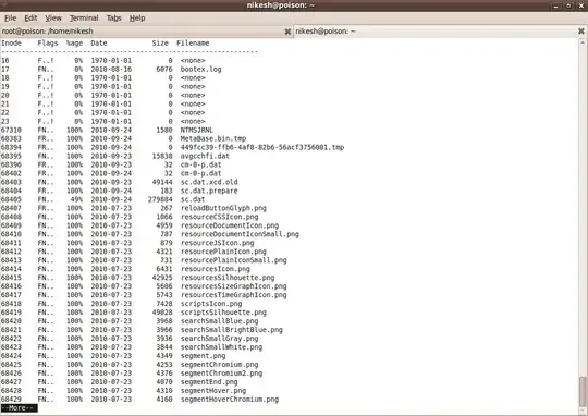

sudo ntfsundelete /dev/sdaX
where X depends your NTFS partition. it will show your list of recoverable files. You can recover.The names of files that can recovered show up in the far right column. The percentage in the third column tells us how much of that file can be recovered.
For example To quickly recover the PNGs, we will use the * wildcard to recover all of the files that end with .png. Open up the terminal window, enter:
sudo ntfsundelete /dev/sda1 –u –m *.png
For more detail you can visit here.
