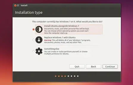

In the Ubuntu installation, when the user gets to the part about selecting which method to use to install Ubuntu, the user will find several options like the ones shown below:
If the user already has Windows on the computer, will selecting "Replace Windows X with Ubuntu" modify the partition where Windows is installed or will it format the whole drive.
There are several doubts regarding this, from other letters (As in Windows D:, E:...) deleted because they were in the same physical drive to not reading the other partitions because of the same reason.

On installation whenever the installer finds another OS on the drive we can choose to install "Alongside" in dual- or multi-boot, or we can choose to "Replace..." an existing OS with Ubuntu.
"Replace" in the case of one harddisk
This will repartition the enire drive with standard partitions for Ubuntu. All other partitions including Windows (e.g. C:), and all data partitions (e.g. D:, E:,...) on that drive will be deleted and overwritten.
This also is why we have so many questions from unfortunate people who erroneously assumed that only a single partition will be used.

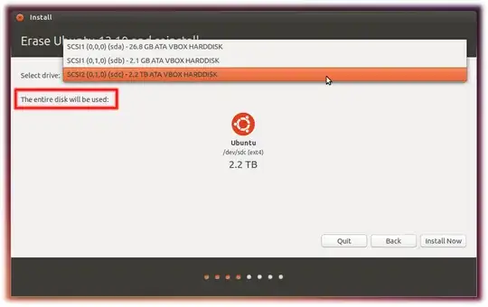

"Replace" in the case of several harddisks
This is different on a system having more than one physical drive. The installer then lets us choose which drive to use. Still, the drive chosen will be deleted and repartitioned as a whole.
Installer of 14.04. in Virtual Box
