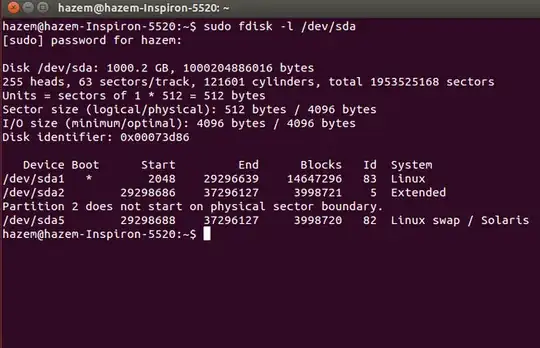

I've just installed Ubuntu 14.04 and I was also using windows 8. I was preparing an un-allocated partition of 25 GB from Windows to Ubuntu.
In the installation of Ubuntu I did not find the option of "Install Ubuntu alongside Windows 8", so I've chosen "something else" & selected sda then clicked new partition table, created a swap area around 4GB. Finally the rest partitioned as root for the system with size of 20GB.
Once the installation finished; neither can I boot into Windows nor find my NTFS partitions (C, D, E).

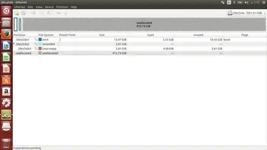

You should have zapped the GPT data before if you could not find the windows partitions. Now, of you are able to boot into Ubuntu, installed gparted and check if the windows partition has boot marked on it.

As you can see in the output of fdisk -l /dev/sda, only two partitons are detected :
  • A Linux partition with a boot flag, probably your / filesystem.
  • An extended partition, which actually is a swap.
According to gparted, the rest is unallocated disk space, meaning it has no filesystem, no partitionning scheme, nothing. This is quite like a no man's land.
It is very likely that pieces of your (naturally) fragmented Windows data is spread all over the disk, including in the unallocated space. However, without a proper partitionning scheme and a filesystem, this data is meaning-less and inaccessible. Re-formating the space might cause another loss of data.
Sadly, the comment from Rod Smith is true : everything got messed up. You might be able to recover a few things, but that's it. If you want a piece of advice... this is a good occasion to start over in a beautiful, Linux-based, universe (I'm trying to see the positive, only the positive!)
