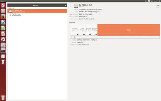

Those are the Partitions which Ubuntu detects
Partition Table
Since i installed Ubuntu, Windows does not show up when i boot my PC , it just goes to ubuntu instantly and does not give me an option to choose.
Is there a way to recover the windows installation or the files? There are so many files i lost now :(
Well from the picture you provided there is no NTFS partition. So you may have accidentally deleted the Windows partition. If so, your best bet is it to try some kind of recovery software.
TestDisk is a great utility for recovering lost and damaged partitions.
