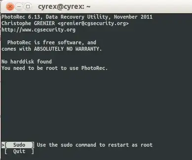

then type photorec in terminal hit enter and input your password then, photorec opened in your terminal.see below given image.
screenshot 1

see screenshot 1 this is now cuurently showing in your terminals.
Here all of your drive available in your system shows up, there in my pc it is only one hard disk available. (it is shows for choosing - which hard drive you wish to recovering files from. )
 using ^ up and down arrow choose which harddrive you want to select  and
     hit proceed.
now you have this type of screen see this screenshot 2
It shows how much partition you have, of that disk
