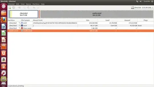

EDIT : This is the GParted version of my current partitions. Now can you please tell me how can I use that unallocated space?
allocated

Linux is not large. But it writes randomly to hard drive not at beginning like Windows. So much of your data may still be on hard drive, but difficult to get to.
Stop using hard drive, only use live system, but Ubuntu live system uses swap and if you have data in swap area on drive it may overwrite that. Most Linux recoveryCD like parted magic or gparted will boot without activating swap.
You can try testdisk. It may see old partitions and deeper search may show files. That would be best case as then you can copy files with full file names. If that does not work then testdisk has photorec which just scans drive for anything that looks like a file, but only restores with file extension not file name. Slow process to run, lots of space on your backup drive needed and then lots of work to rename files. ( I have done it just for a few files and it took forever).
https://help.ubuntu.com/community/DataRecovery
http://www.cgsecurity.org/wiki/TestDisk
https://help.ubuntu.com/community/DataRecovery#Lost_Partition
http://www.cgsecurity.org/wiki/TestDisk_Step_By_Step
http://www.cgsecurity.org/wiki/Menu_Analyse
http://www.cgsecurity.org/wiki/TestDisk:_undelete_file_for_NTFS
http://www.cgsecurity.org/wiki/PhotoRec
