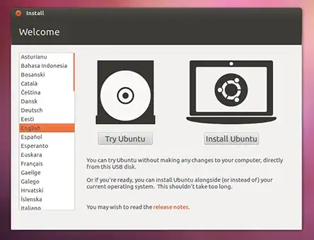

    Reboot the computer from live media and choose Try Ubuntu when asked.
    Try Ubuntu
