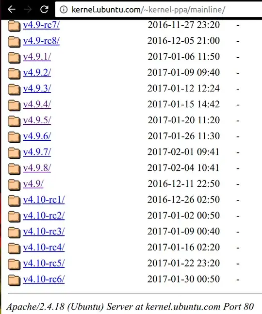

Finding the latest kernel
Go to (kernel.ubuntu.com - Kernel PPA Mainline) and press the End key:

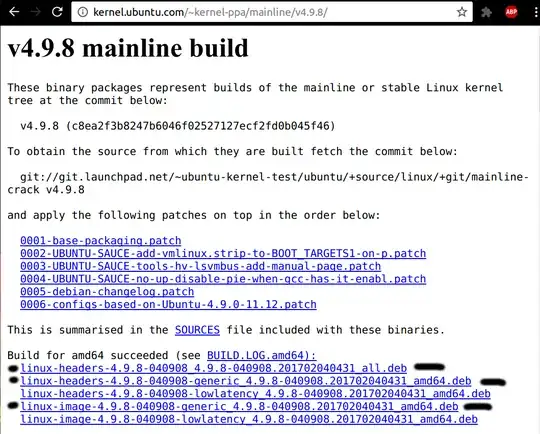

Mainline kernel 1
Now click on the link 4.9.8 (or a newer one if available when you read this) and the following appears:
mainline kernel 2
Note the links with the black airbrush marks. These are the three we will download for Ubuntu 16.04 64-Bit using Intel or AMD processors.
Installing using Terminal
Open a terminal session with Ctrl+Alt+T and use:
cd ~/Downloads # Change to your downloads directory
ll linux*.deb  # Check if any previous downloads still exist
rm linux*.deb  # Use this command if any previous downloads found
Now switch back to the download screen above and single-click on all three of the .deb kernel downloads. After downloads complete (you'll see status in your browser) switch back to terminal session and use:
sudo dpkg -i linux*.deb
rm linux*.deb
sudo reboot
Voila! - you are running the latest kernel when the first option in grub boot menu is selected. Your older kernel versions are still available under grub's Advanced Options menu.
