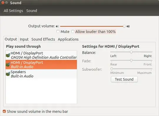

Then today under Kernel 4.13.0-36 I noticed system notification sound for volume change (that popping bubble sound) was coming from second TV driven by Intel HD 530 over USB-C Thunderbolt Display Port to HDMI converter whilst real sound internet video / news channels were coming from main TV driven by nVidia.
So I did a quick screenshot so you could see the setup:
I am using a special kernel module for nVidia sound due to newer Dell Laptops powering off the sound card in newer nVidia Cards to save 5 watts of electricity: https://github.com/hhfeuer/nvhda (not the exact github link but close enough).
