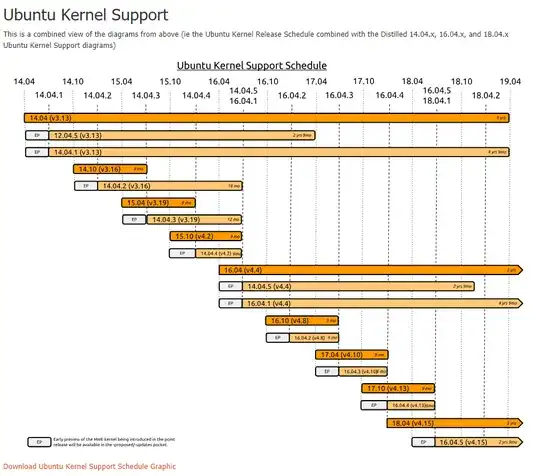

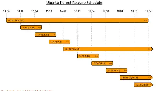

Ubuntu Kernel Release Schedule
Ubuntu Kernel Support Schedule
ref Ubuntu Kernel Support and Schedules
