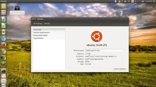

As compared to windows battery consumption in Ubuntu is double.
Device - Dell Inspiron 3521
