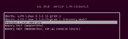

As you can see, only the latest kernel is displayed.
If you select the option shown (press Enter) then all the old kernels become visible and available to boot from.
GNU GRUB Previous versions

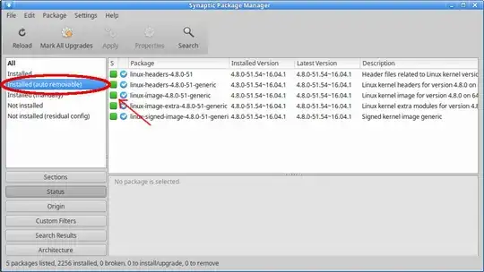

An alternative is Synaptic (sudo apt install synaptic)
search for linux-image, right-click a kernel and choose complete removal and finally click the Apply button to delete the kernel.
Synaptic Package Manager
Repeat the search but this time for linux-header - you can delete the associated headers for the kernel image chosen previously.
Synaptic though will not attempt to verify what you are trying to remove... you could inadvertently delete your newest kernel - or even delete all of your kernels via this tool leaving you with an unbootable Ubuntu!.

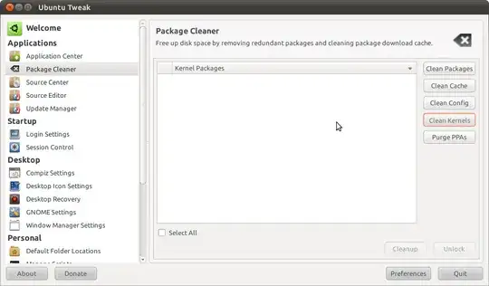

  • A great tool for removing kernels (and menu entries) is Ubuntu-Tweak, a safe and easy-to-use GUI app.
  • Install ubuntu tweak
  • Ubuntu-Tweak will be available under Applications > System Tools.
Remove Older Kernel Entries
  • Select "Package Cleaner" on the left and "Clean Kernel" from the right panel.
  • Press the "Unlock" button at the lower right, enter your password.
  • Select from the displayed list the kernel images and headers you wish to remove. The kernel in use is not listed.
  • Press the "Cleanup" button at the lower right to remove the selected kernel images and headers.

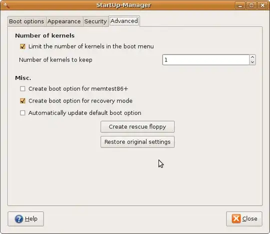

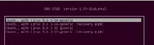

Alternate way to remove Kernel entries (prior to 10.04)
for GRUB not GRUB2
startupmanager Install startupmanager
You can find it under System>>Administration>> alt text
alt text
You see in the second screenshot you can select how many kernels to show? I generally just keep it on 1, but when I get a kernel upgrade I always change it to 2 before restarting so I can select the older kernel if the new kernel has problems with my hardware. Once I know the new kernel is working well I change it back to 1.

In order to remove older Linux image kernels, first boot in the kernel you want to keep.
You can also check the kernel version using command uname -r so that you don't remove the wrong one by mistake.
Now go to synaptic package manager and search for linux-image and remove the older versions except the one shown by upper command. Generally I prefer to go with the latest one.
Now when you restart you'll see a more clean grub menu.

You could install ubuntu-tweak and then Go to Applications -> System tool -> ubuntu tweak and
enter image description here click package cleaner and clean kernels. it does not show the currently used kernel so you will always be safe.
Lincity
  • 25,749
Personally, I like using Synaptic. It makes me feel more secure about what's going on. The only app I've used that has an option to remove old kernels is Ubuntu Tweak.
How to remove the kernels you are not using:
  • Open UbuntuTweak
  • Click on 'Package Cleaner' under 'Applications' in the left-hand pane
  • On the right side of the 'cleaning view' press 'Clean Kernels'
  • Select all kernels - I think the one in use is not listed but just in case check running uname -a in a terminal

You can uninstall the old kernels (linux-image-... packages) using Synaptic, and that will remove them from the boot menu. Take care not to remove the running kernel (you can check its version with uname -r).
Bear in mind that having a one or two older versions can help you troubleshoot, should something go wrong.
Alternatively, you can edit/remove the entries manually (gksu gedit /boot/grub/grub.cfg), but they will be re-generated when you update to a newer kernel. If you are thinking about removing recovery mode options - don't. They can come in handy if you break something which prevents you from booting.

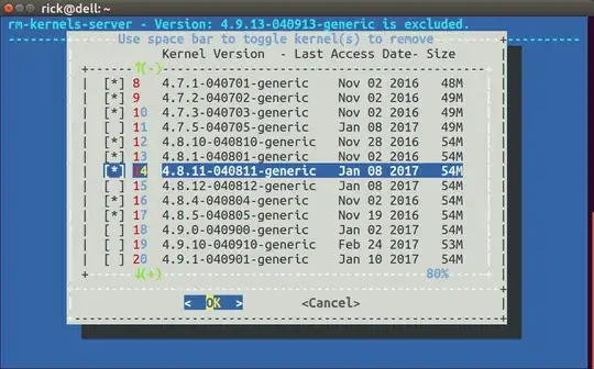

Server Version
rm-kernels-server is the server version to selectively delete kernels all at once. Instead of a GUI (graphical) dialog box a text-based dialog box is used to select kernels to purge.
  • Before running the script you need to install the dialog function using:
    sudo apt install dialog
Dialog is in the default Ubuntu Desktop installation but not in Ubuntu Server.
Sample screen
rm-kernels-server 1
rm-kernels-server bash code

NOTE: In the call to dialog the directive --ascii-lines is passed to replace line-draw extended character set (which ssh doesn't like) with "+-----+" for drawing boxes. If you do not like this appearance you can use the --no-lines directive for no box at all.
July 28, 2017 Updates
The calculated size of each kernel was taken from /boot/*kernel_version* which were 5 files totaling ~50 MB. The formula has changed to include the files in /usr/src/*kernel_version* and /lib/modules/*kernel_version*. The calculated size for each kernel is now ~400 MB. The above code for rm-kernels and rm-kernels-server has been updated. However, the sample screens above do not reflect these changes yet.
The default is to estimate the size of files for linux-headers at 125 MB and linux-image at 220 MB because du can be painfully slow unless files are in cache. To get the real size using du pass any parameter to the script.
The total of all kernel sizes (excluding the current running version which cannot be removed) is now show in the title bar.

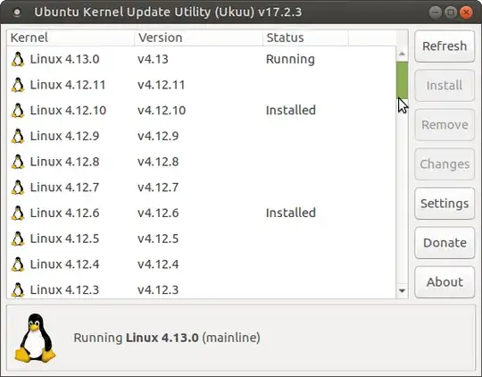

You can use ukuu - it's all GUI - to update and delete old Kernels. Works for me!
Just remember leave the last 2 installed and obviously the 'running' kernel.
You can also set ukuu to only show mainline releases, even RC kernels, hide point releases.
ukuu
You can find ukuu in Synaptic, or instructions are here:
OMG!Ubuntu ukuu install instructions
Install the synaptic package manager and go down to the filters tab (I think filters, if not try all 5) and select "local". This will show you orphaned packages on your system, such as the kernels. After you uninstall them, run update-grub. That command updates the list of boot options for grub.
If this fails, you can always try apt-get remove linux-image-version-generic.

I give two safer variations of the methods in other answers: one using synaptic manager and the other using terminal.
With these variations you only remove packages that the system identifies as removable. There is no risk you remove linux kernels that are currently used—as it happened to me some weeks ago ;-(
Using Synaptic Manager
Instead of searching linux-image over all installed packages, select the autoremovable packages (See red ellipse in the picture below). Now from this list remove the linux-image you want.
Using terminal
Similarly, if you are removing kernels on terminal, show only the autoremovable kernels by running
 sudo apt-get -s autoremove | grep linux-image
And then remove whichever kernel linux-image-x.x.x-x-generic you want to remove from the given list by running
 sudo apt-get purge linux-image-x.x.x-x-generic
