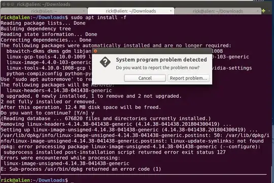

dpkg: dependency problems prevent configuration of linux-headers-4.14.38-041438-generic:
linux-headers-4.14.38-041438-generic depends on libssl1.1 (>= 1.1.0); however:
Package libssl1.1 is not installed.
dpkg: error processing package linux-headers-4.14.38-041438-generic (--install):
dependency problems - leaving unconfigured
Setting up linux-modules-4.14.38-041438-generic (4.14.38-041438.201804300419) ...
Setting up linux-image-unsigned-4.14.38-041438-generic (4.14.38-041438.201804300419) ...
/var/lib/dpkg/info/linux-image-unsigned-4.14.38-041438-generic.postinst: 50: /var/lib/dpkg/info/linux-image-unsigned-4.14.38-041438-generic.postinst: linux-update-symlinks: not found
dpkg: error processing package linux-image-unsigned-4.14.38-041438-generic (--install):
subprocess installed post-installation script returned error exit status 127
Errors were encountered while processing:
To fix errors I tried sudo apt install -f but it won't fix it plus causes a "crash report":

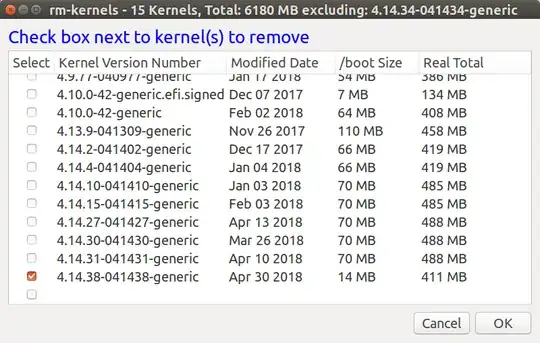

Using sudo rm-kernels I removed 4.14.38 as much as I could:
This time around only the headers were successfully removed:
The following packages will be REMOVED:
linux-headers-4.14.38-041438*
0 upgraded, 0 newly installed, 1 to remove and 2 not upgraded.
1 not fully installed or removed.
After this operation, 74.6 MB disk space will be freed.
Do you want to continue? [Y/n] y
(Reading database ... 665813 files and directories currently installed.)
Removing linux-headers-4.14.38-041438 (4.14.38-041438.201804300419) ...
dpkg: error processing package linux-image-unsigned-4.14.38-041438-generic (--configure):
E: Sub-process /usr/bin/dpkg returned an error code (1)
