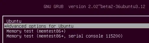

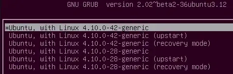

  • GRUB which seems to allow choosing specific kernels to boot from
(screenshots for illustration, not reflecting latest version) enter image description here enter image description here

The package for the linux kernel is separate from the nvidia drivers. But each kernel version has its corresponding drivers. If you had the nvidia drivers installed for, say, 4.10.0-28, then booting that kernel should use the corresponding drivers.
Other modules may be provided by different packages, e.g., linux-modules-5.8.0-45-generic, linux-modules-extra-5.8.0-45-generic.
So you should already have your "restore point"s, and you can use them via grub, as you show. As for the custom entries in grub, you don't need that for older kernel versions, those are added automatically when updating. You might need that if you want other customization, though.

It's not what I would call a "custom" kernel but many will call it such. When you upgrade within the same kernel chain, say 4.14.188 to 4.14.216 like I did last month grub doesn't automatically make it the new default on the main menu:
So after kernel update go into "Advanced options" and select the new kernel. Make sure you configure grub to always boot with the last used option:
