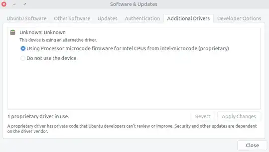

And I don't have any graphics driver installed.

Thank you in advance! enter image description here
