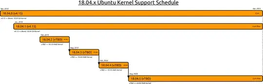

If you prefer system stability - then you can test Ubuntu 18.04 LTS from LiveCD and then install it.
About the kernel - it seems that you are talking about LTS Enablement Stack.
See particular section named 18.04.x Ubuntu Kernel Support:
18.04 kernel HWE
(Click image to enlarge)
So updated kernel will be released with the release of Ubuntu 18.04.2 LTS (February 2019).
If you want to test newer kernel on already installed Ubuntu 18.04 LTS - you can always test newest mainline kernel.

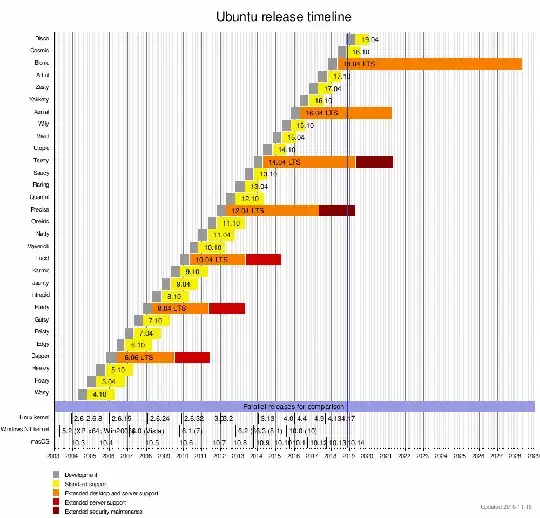

You can install (upgrade to) 18.10 (October 2018) and then upgrade to the future standard release (19.04, meaning April 2019). It should be available during the month indicated by its version number, before the end of the nine-month support period of 18.10 (July 2019). Then, continue to upgrade to the future 19.10 (= October 2019), before the next LTS 20.04.
Standard versions are released every 6 months (each April and October) and each new standard version is meant to be available before support for the current standard version is dropped. - Short-term releases are mean to be upgraded to the next version (be it short-term or LTS) as soon as possible.
If we look at the Ubuntu's release cycle, (also on Wikipedia) we can see that all versions, both standard and LTS have support periods that overlap.

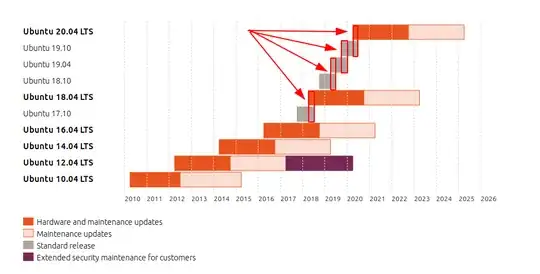

Desktop users can join a refreshed kernel when point releases happen. It's called the "HWE stack" (Hardware Enablement) and also called "LTS Enablement, but HWE is how these packages are described so I prefer 'HWE'. Its primary focus is more modern kernels for newer hardware.
18.04.1 doesn't count ... it's just a bug fix a few months after 18.04. Not a new kernel.
18.04.2 brings the 18.10 kernel (after a suitably conservative delay to make sure it is very stable) 18.04.3 brings the 19.04 kernel 18.04.4 brings the 19.10 kernel
The trip stops there. If you want to stay cool and trendy, you are expected to jump to 20.04 which is the next long term release. Actually, 20.04.1 is the recommended time to upgrade.
