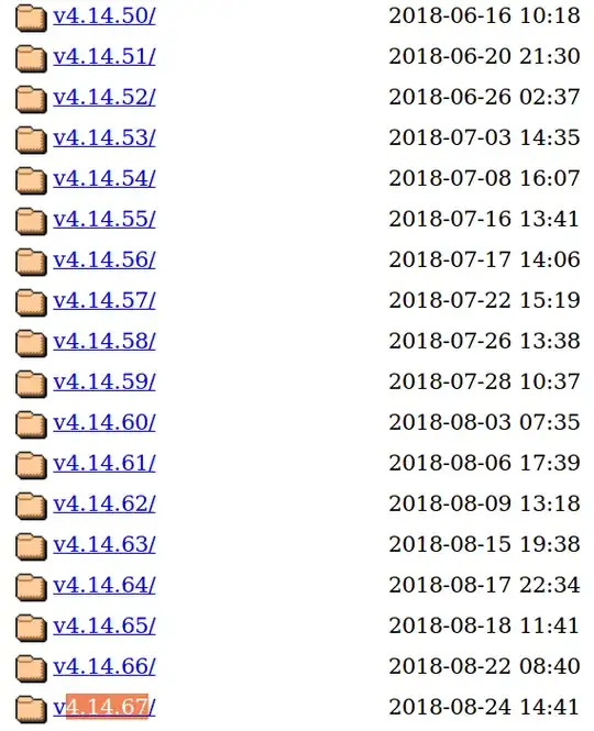

It's relatively straight-forward installing a different kernel: How to update kernel to the latest mainline version without any Distro-upgrade?
The latest kernel in the 4.14.xx chain is 4.14.67.
That said I've found kernel chain 4.13.0-xx-generic which Ubuntu maintains very stable compared to the 4.15.00-xx-generic kernel chain Ubuntu maintains. The advantage of staying on a Ubuntu kernel chain is it is automatically upgraded for you when new versions come out.
When you are on the 4.14.xx LTS Linux Kernel Chain you must periodically review when new kernels come out and install the new ones manually using the above link.
