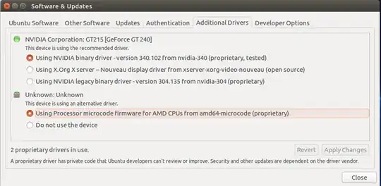

13
Go to "synaptic-settings-repositories-additional drivers." See if you have a "Unknown Unknown" radio button If you have, then select it as I have in picture. Two weeks I have not had one freeze.
