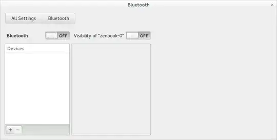

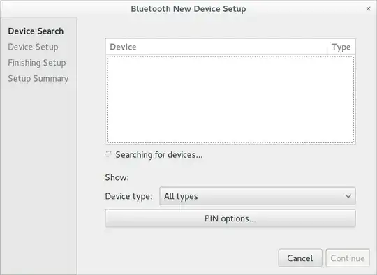

I cannot find it from:

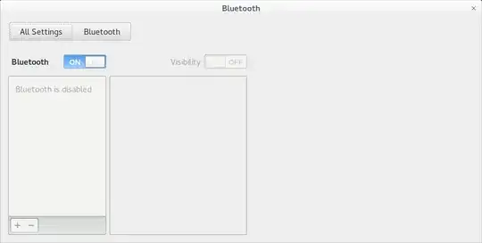

I cannot even turn bluetooth on from:

Now I can turn it on, but adding device button is disabled.

For Ubuntu 14.04 LTS:
1) Go to the bluetooth icon, typically top right of your screen
2) Set Up New Device...
3) Device type: Headphones... other audio devices.
That should make the speakers visible. Select, continue & enjoy.
