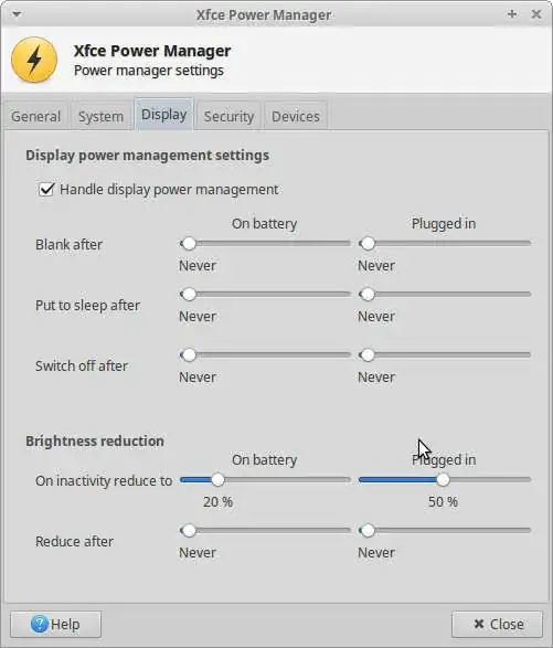

I have a HP Elitebook 820 G1 laptop with Xubuntu 16.04 installed. Even though my power management settings in XFCE looks like this:
the monitor will go to sleep after X minutes and not wake up again.
Are there any special drivers I could look into to get this working?
