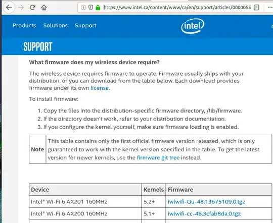

Here are the Canadian Instructions:
You can install any kernel you want in Ubuntu:
without having to upgrade your desktop (eg 16.04 -> 18.04 -> 19.04) in order to get a new kernel version. Upgrading your desktop can result in operations loss (won't boot), in a steep learning curve and loss of functionality (but usually offset by gains in new functionality). Backups are strongly recommended when upgrading desktop. So you should plan carefully if all you want is a new kernel. Upgrading just a kernel (and keeping desktop) doesn't require a backup because the old kernel is still there to boot from.
For my case, kernel 4.15.0-62 (ubuntu 16.04), with the use of backport driver as state by Anthony Wong,installing the driver from https://www.intel.com/content/www/us/en/support/articles/000005511/network-and-i-o/wireless-networking.html. The wifi work for me (not at 1Mbps).
