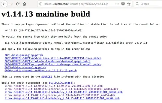

Spectre protection (Retpoline) was released for Kernel 4.9.77 and 4.14.14 by the Linux Kernel team on January 15, 2018. The Ubuntu Kernel team only released kernel version 4.9.77 on January 17, 2018 and have not published kernel version 4.14.14. The reason is unclear why but 4.14.14 has been re-requested as answered in Ask Ubuntu: Why was kernel 4.9.77 released but not kernel 4.14.14? and didn't appear until today.
January 17, 2018 Adding Spectre Support to Meltdown
I thought some would be interested in the changes in 4.14.14 (from 4.14.13) as documented in programmers' comments which I think are pretty detailed for kernel C programmers from my limited exposure. Here are the changes from 4.14.13 to 4.14.14 kernel focusing mainly on Spectre support:

Kernel 4.14.13 Installation
More Meltdown revisions and beginning of Spectre features were introduced in Linux Kernels 4.14.13, 4.9.76 and 4.4.111.
There are reasons why you want to install the latest mainline kernel:
  • A bug in the last Ubuntu LTS kernel update
  • You have new hardware not supported in the current Ubuntu LTS kernel update stream
  • You want a security upgrade or new feature only available in the latest mainline kernel version.
As of January 15, 2018 the latest stable mainline kernel is 4.14.13. If you choose to manually install it you should know:
  • Older LTS kernels will not get updated until they are greater than the main menu first option titled Ubuntu.
  • Manually installed kernels are not removed with the usual sudo apt auto-remove command. You need to follow this: How do I remove old kernel versions to clean up the boot menu?
  • Monitor developments in the older kernels for when you want to get back on the regular LTS kernel update method. Then delete the manually installed mainline kernel as described in the previous bullet point link.
  • After manually removing the newest mainline kernel run sudo update-grub and then Ubuntu's latest LTS kernel will be the first option called Ubuntu on Grub's main menu.
Now that the warning are out of the way, to install the latest mainline kernel (4.14.13) follow this link: How to update kernel to the latest mainline version without any Distro-upgrade?
