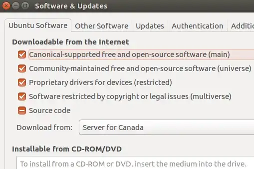

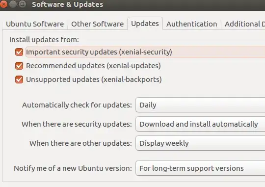

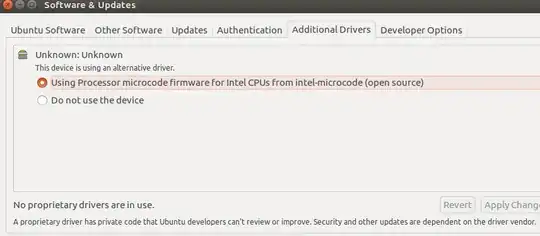

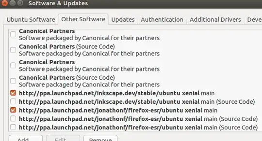

I have Ubuntu 16.04. "Software Updater" suggests periodically many update components. I can't understand the usefulness of everything. I am wondering whether it is safe to let it install all suggested updates.
Edit:
Here are screen-shots of the "Software & Updates" selected options:
Ubuntu Software
Other Software
Updates
Additional Drivers
Developer Options
Zanna
  • 72,312
The answer depends almost entirely upon which software sources you have enabled in your Software & Updates control panel.
If you stick to the official Ubuntu repositories, you usually will get safe, signed, tested updates that you can install worry-free. Perhaps once or twice a decade one of these update may cause a problem, so regular backups are still wise.
Caveat: Do NOT enable the Ubuntu -proposed repository unless you are helping to test the proposed software. Those will sometimes cause problems. That's what testing is: Discovering the problems.
If you have added a lot of non-Ubuntu sources (like third-party sources and certain PPAs), then the risk of a crash, conflict, or other problem goes up substantially.
