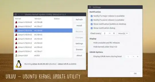

what you're looking for is ukuu
install :
sudo add-apt-repository ppa:teejee2008/ppa
sudo apt update && sudo apt install ukuu -y && sudo ukuu
usage :
ukuu usage
as per : How to update kernel to the latest mainline version without any Distro-upgrade?

I finally solved my issue by using UKTools and selecting the latest stable kernel published in mainline, now my touchpad works flawlessly. Output of uname -r, which shows the kernel with support for my touchpad:
5.0.21-050021-generic
What I like about this is that the kernel with support is not too far away, and in the very close future there will be support for this particular elan touchpad.
