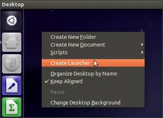

In older versions it was easy to create a launcher on my desktop. All I had to do is right click on my desktop and select the "create launcher" option.
How can I create such launchers now?

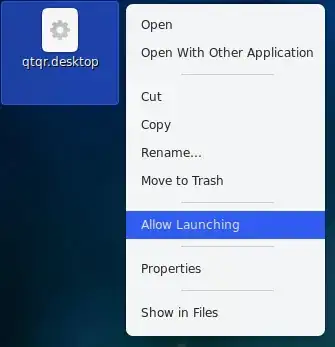

Don't forget to make the file executable (chmod +x something.desktop)
OR click right mouse button on that label and select 'Allow launching' (Tested in Ubuntu 19.04).

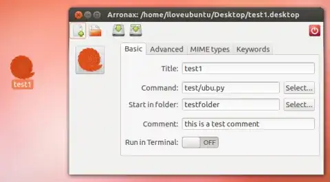

There is cooler way: Arronax
arronax
picture taken from source link below
to install that type in terminal (to open Ctrl+Alt+T):
sudo add-apt-repository ppa:diesch/stable
sudo apt-get update
sudo apt-get install arronax
nautilus -q
cooler because it has drag&drop and more functions with GUI
Read more from

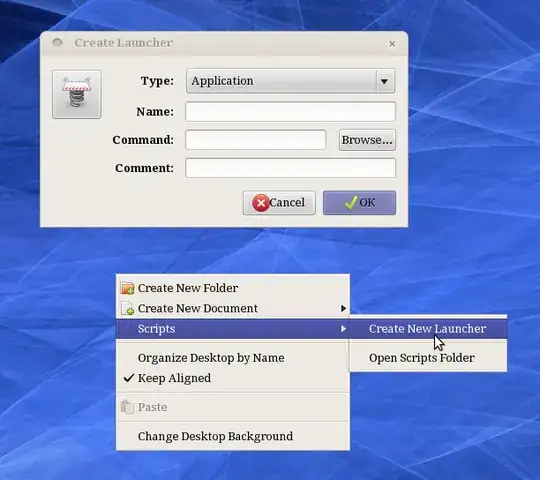

38
No longer works in latest version, desktop icons were completely removed.
This Is a solution to get it back on the right click menu In Gnome and Unity,
1- Install gnome-tweak-tool Install gnome-tweak-tool, if you don't already have it, In terminal paste-
sudo apt-get install gnome-tweak-tool
2- Then type the following to launch it
gnome-tweak-tool
Or use the key shortcut Alt+F2 type gnome-tweak-tool then click "Run"
3- Navigate to the "Desktop" tab on the left pictured - And turn ON
"Have file manager handle the desktop"

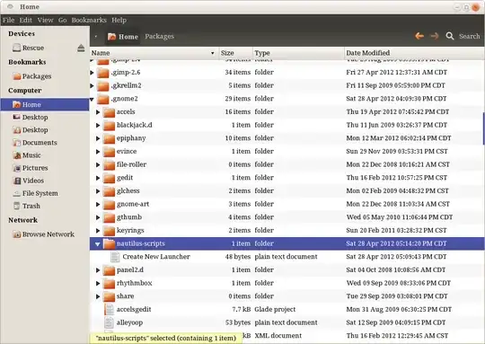

4-Source for this part: 1 Now we are going to create a Script to put on the right click menu -
Open gedit either by terminal or Alt+F2, Paste the code
gnome-desktop-item-edit ~/Desktop/ --create-new
put only this into the new text document and then save it as "Create New Launcher" no extension needed (you may need to use .sh as extension ex "Create New Launcher.sh", if you can't make it executable in the next step).
5- Now we need to make the file executable, Right click on the file go to > Properties > click Permissions tab > look for "Execute" and check "Allow executing file as program" then close out.
6- Open the file browser, go to > View > Show Hidden Files, now navigate to you home folder, and Place the file in ~/.gnome2/nautilus-scripts . Shown below -
7- Now we have Create new launcher on the right click menu! Right click on your desktop and go to > Scripts > Create New Launcher Then fill in the comand information for the application you want,
Shown below- enter image description here

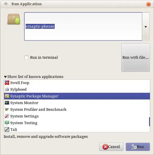

If you forget what the app's launch command is click "Browse" then navigate to File System > usr > bin which is /usr/bin , these are the applications on your system, most should automatacally find the icon after you click "Open" , although they won't show up before.
If It dosn't show the icon when you get back to the "Create Launcher" box you can drag a icon in by finding the icon in /usr/share/icons . There are default icons in the various theme folders or specific icons in the /usr/share/icons/hicolor/scalable/apps or /usr/share/icons/hicolor/48x48/apps, or if later you want to put an icon in you can right click > properties to drag and drop the icon in.
(This part only for gnome, alt+f2 is diffrent in unity) Another way to list known applications is to hit Alt+F2 and click on the app under "Show list of known applications", you can then copy the command text for that program to paste in to
All this will make it extremely easier to make custom launchers, and once setup you can make them without the terminal.

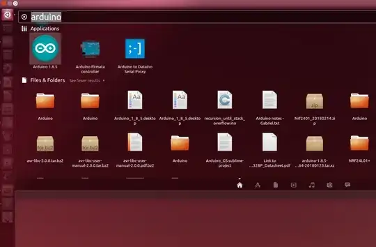

An easier way to create a launcher for a program:
If you can find the program in your dash, just click and drag the icon for the program in your dash onto your desktop or wherever else you would like it. :)

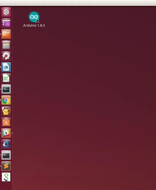

Screenshots:
My Desktop with the newly-created shortcut:

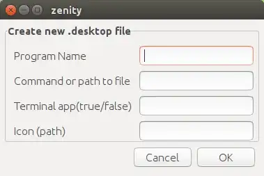

Considering previous answer by Scaine , the gnome-panel way installs dependencies, but at the very bottom of things - we don't really need those, we just need to have .desktop files created. Thus , I've put a small script that does exactly that, the graphical way, creating a named .desktop file in the ~/Desktop folder, readily available for use and pinning to the Unity launcher. Not the best scripting here, but does the job.
This can be saved as file named makeLauncher.sh , change permissions from Right Click -> Properties -> Permissions -> Allow executing file as program, and it's ready to go.
#!/bin/bash
FORM=$(zenity --forms \ --title="Simple shortcut maker" --text="Create new .desktop file" \
        --add-entry="Program Name" \
        --add-entry="Command or path to file" \
        --add-entry="Terminal app(true/false)" \
        --add-entry="Icon (path)")
[ $? == 0 ] || exit 1
awk -F'|' -v home="$HOME" '{
    FILE = home"/Desktop/"$1".desktop"
        print "[Desktop Entry]" >> FILE
        print "Type=Application" >> FILE
        print "Name="$1 >> FILE
        print "Exec="$2 >> FILE
        print "Terminal="$3 >> FILE
        if ($4 !~ /^[ ]*$/)
            print "Icon="$4 >> FILE ;
    system("chmod 755 " FILE);
}' <<< "$FORM"
And here's how it looks
Side note: sadly, zenity's form field doesn't have checkbox for a forms widget, so the true/false for Terminal app option has to be typed. I am considering rewriting this script in PyQt.

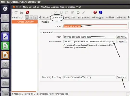

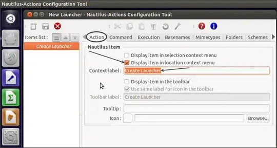

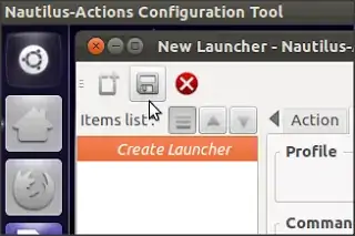

This can be easily be achieved using nautilus-action & gnome-desktop-item-edit.
STEPS:
  • Install nautilus-action by running following command in terminal:
    sudo apt-get install nautilus-action
  • Launch Nautilus-Actions and create a new action.
  • Under the Action tab, check on "Display item in location context menu", then in Context label, enter this: Create Launcher.
nautilus-action-create-launcher1
  • Open now the Command tab and enter the following details:
    Label: Create Launcher
    Path: gnome-desktop-item-edit
    Parameters: --create-new %f
    Working directory: Click Browse and select your Desktop folder.
  • Leave rest of the tabs as it is.Save now your command and exit:
  • Restart Nautilus:
    nautilus -q
  • You can add shortcuts from the context menu by selecting Create Launcher
The shortcut is added in your current directory you right-click on
DONE!
