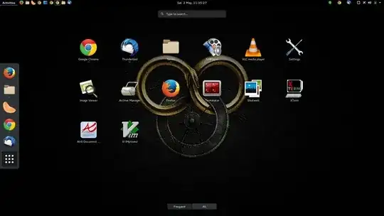

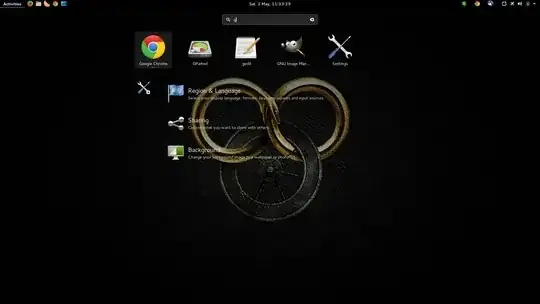

From here, simply type (part of) the name of the program, or something in its description, and press enter when it is highlighted:

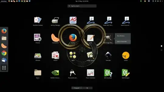

The list of icons on the left is customizable. If you want to add an icon to it, for commonly-used applications, you can go to the Applications overview and drag an icon to it:

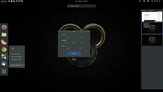

Or right click an icon and Add to Favourites:
To get to the Applications overview, you can do any one of:
  • Click on the matrix of dots:
  • Press SuperA.

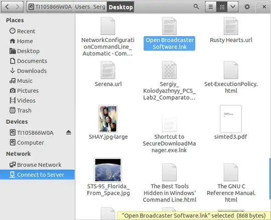

If you ever have tried opening windows partition with linux you will see that essentially, a windows desktop shortcut is nothing more than a link file. Now, just because windows days "create a shortcut" doesn't mean that unix-like file system has to call their way of doing think "create a shortctu",too.
For instance, bellow you will see a screenshot of my windows desktop opened with Ubuntu's default file manager - nautilus. Highlighted is a shortcut to Open Broadcaster Software , which is used to broadcast videos on sites like twitch.tv
Now, unix-like systems have implemented creating links to files and folders long ago before windows existed. If you right click in Nautilus, you will see a line saying "Create a Link". Same idea as windows shortcut ( which is actually a link, but windows calls it shortcut ) !

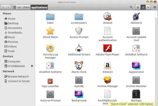

Now, let's go to /usr/share/applications folder on Ubuntu. You will see there a list of all installed applications on your system. Now you can either copy one of those files to desktop and open with double click; alternatively, press AltF2 and run gksu nautilus /usr/share/applications, which opens file manager in that directory, right click and chose create link. Now you can move that link to desktop.
Bellow you can see my folder, with a link created to a solitaire game.
