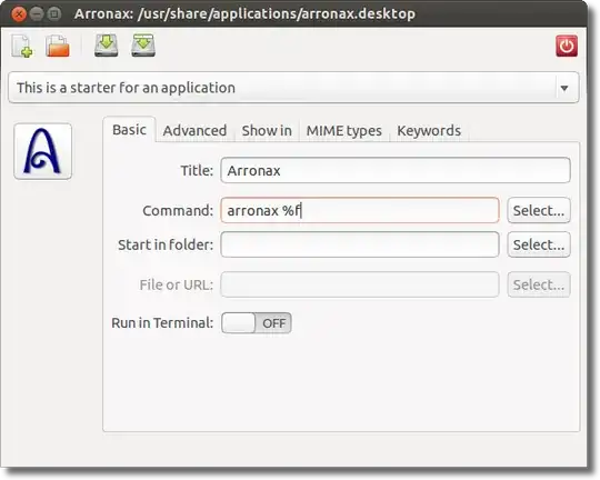

Have a look at my project, Arronax:
launcher creation dialog
It's available as a plugin for Nautilus and as a standalone application.
To install, open a terminal and type:
sudo add-apt-repository ppa:diesch/stable
sudo apt-get update
sudo apt-get install arronax
nautilus -q

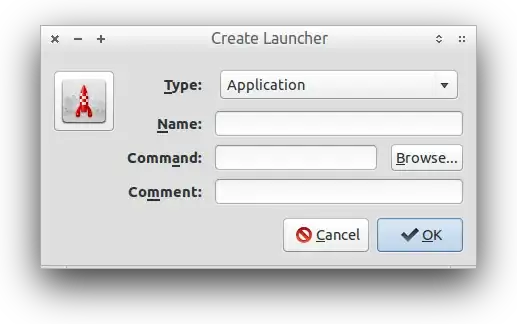

On Ubuntu 12.04 or 14.04 there's gnome-desktop-item-edit which comes as part of the gnome-panel package:
You could integrate this into your file manager with the following script:
#!/bin/bash
gnome-desktop-item-edit --create-new ~/.local/share/applications
Generic installation instructions for Nautilus scripts: How can I install a Nautilus script?

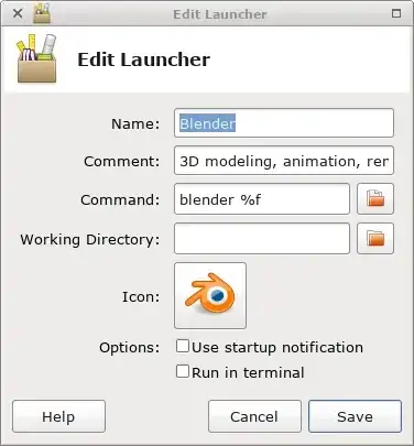

For the Xfce desktop environment there is exo-desktop-item-edit, it works similar to it's Gnome counterpart:
exo-desktop-item-edit --create-new ~/.local/share/applications
Screenshot

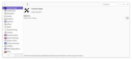

I have always used alacarte to get this done, However it seems that alacarte is no longer functional for me on Ubuntu 23.10+ (crashes/freezes on most of the actions).
I came across a similar tool called MenuLibre which works perfectly to achieve the same. It can be installed using:
sudo apt install menulibre
then it will be available under your Applications with the name "Menu Editor" MenuLibre GUI
Another thing that I noticed on Ubuntu 23.10+ is that the application entries which I created either using Alacarte or MenuLibre show with gray gear icons on my dock when launched.
To solve this, I had to specify the proper Startup WM Class for each entry MenuLibre Advanced settings
Refer to What does the StartupWMClass field of a .desktop file represent? to learn how to obtain the WMClass of any application on both X11 and Wayland
